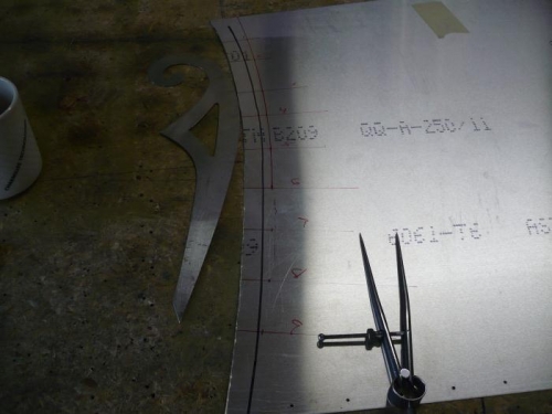

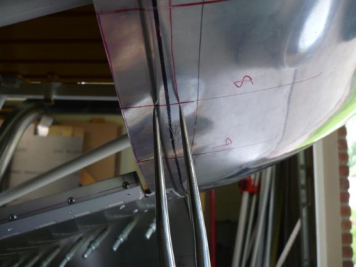

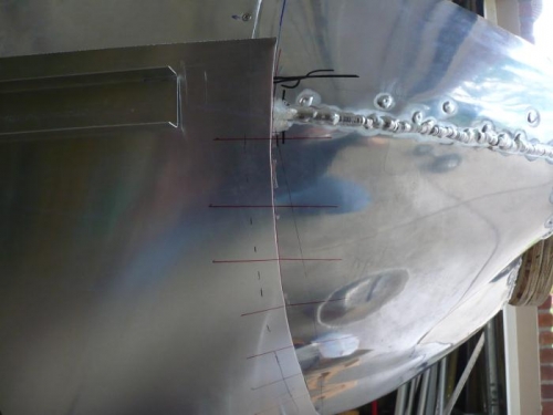

Brief Description:  Layout and trim front lower cowl panels
The cowl fit is to tight to use a line transfer tool so geometric layout was used. Straight lines, pick up points on the lines and transfer to the panel. Build line using soft french curves against 3 points.
