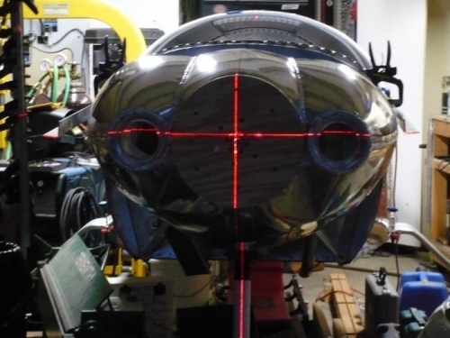

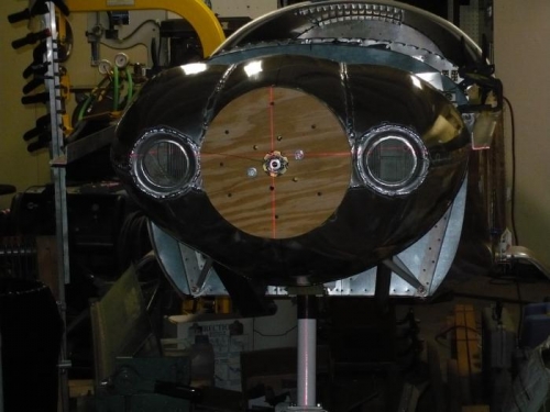

Align Nose Bowl with Fuselage
Line up the laser light with the fuselage longerons and centerline, checked and adjusted the nosebowl so it presents correctly to the wind.
If you look real close you can see the one degree down and 1/2 degree lateral offset at the prop hub center.
