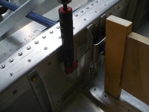

Brief Description:  Position front control stick bearing

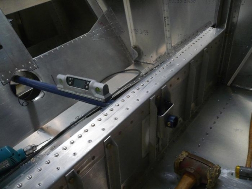

Valdate that the angle is parralel to the upper longerons.

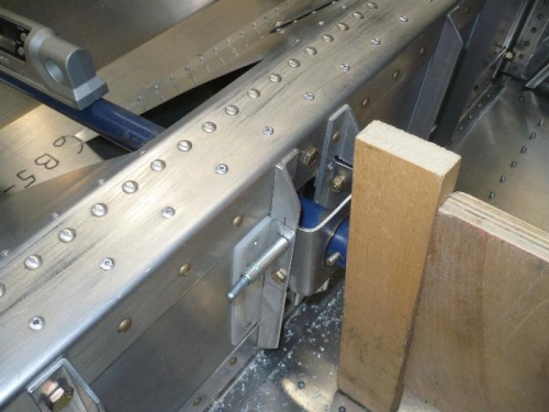

Wedge the control bearing back and square to the end of the tube. Check angle and clearance. Mark and drill pilot holes with Tight Fit Drill, c;eco in place.
Drill to size and install bolts.
