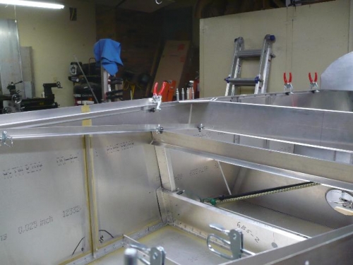

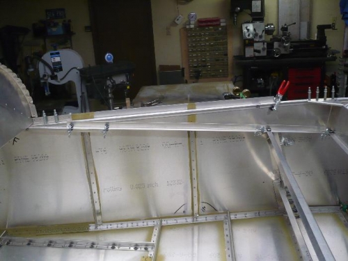

Rear baggage floor
Need to remake the uprights on 6B5. First establish the line that the baggage floor will run on. Did that with some straight light L-Angles clamped to the forward and rear surfaces that the baggage floor attach to.
