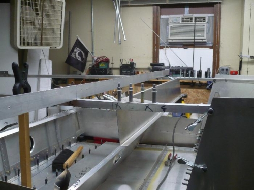

Upper Seat & Baggage Floor Support

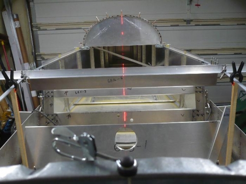

Set width by clamping angle crosswise. Clear out top edge of 6B16-6 to clear the upper longerons.

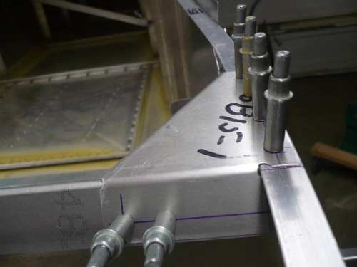

Clear corner so 6B15-1 sets flush on 6B16-6.
Get everything clamped in place and check location again. Pilot drill and cleco to hold in place.
Stand back and admire...
