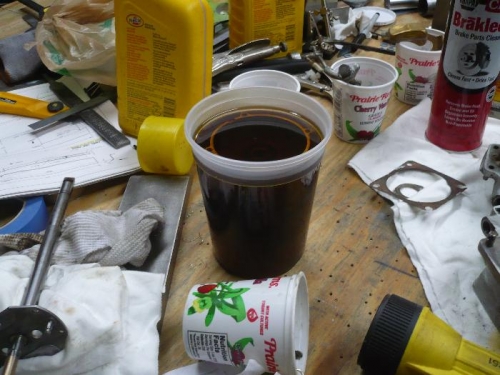

Brief Description:  Face off bottom bushing on Distributor
Took .048 off the end to provide .004 end play.
Cleaned it out real good with Brake Clean and brush. Ran shaft at 1500 rpm in distributor body with oil on bushings, no drag and no heat build up.
Soak bushings in oil so they can drink it up.
Soaking up oil
Soaking up oil
