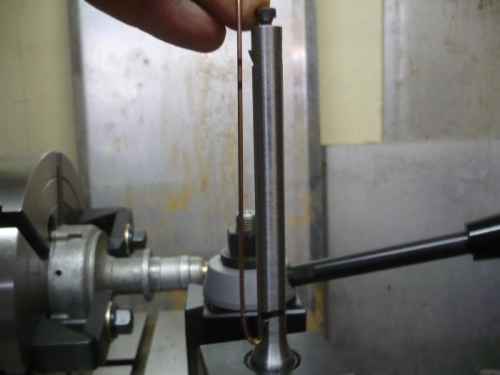

WW Distributor
Drilled out center and bored ID of bushings
Reset and trammed distributor base.
Drilled out excess material to within .04" of finish steping up from 3/8 in 1/32" increments, every other drill bit in my set.
Marked boring bar to show stat and stop of the bushings.
Took .005 rough cuts in and feed in and out without changing the cut depth.
Drill out excess material
Mark boring bar
Boring, boring, boring
