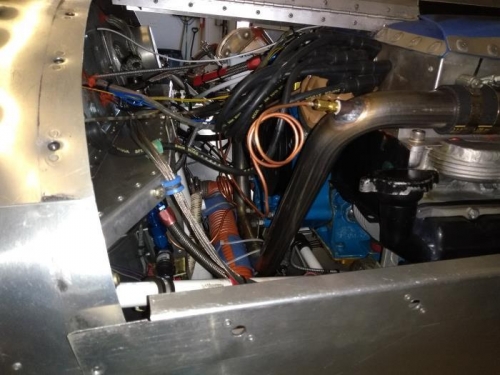

Prepare the intake manifold:
A hole was made right where the center of straight head pipe intersects the bend for the 1/8 SS Coupling. The Coupling was placed in the hole and marked for trimming before welding. (want to keep the inside as smooth possible as the air mixture comes arounf the bend in the intake manifold.

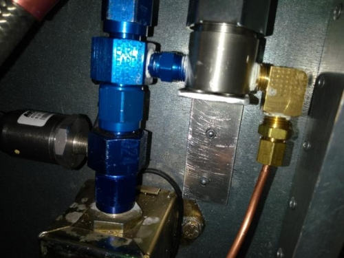

Purchase 100199ERL and 991101ERL for adding the Soleniod to the system.
Assemble and test fit Soleniod with all fittings attached.
Make bracket to support the weight of the Soleniod.

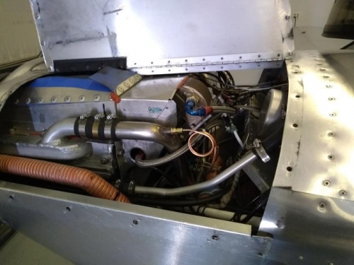

Install manifold and route copper tubing making two bends for vibration. Trim left and right tubes to the same length at the TEE. Route TEE line to the Soleniod agaain adding the two bends for anti vibration.
Left side
Left side
Right Side
Right Side
