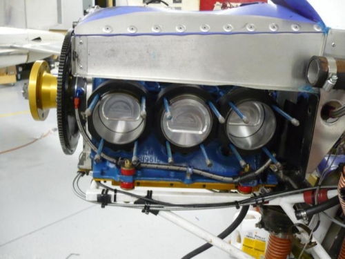

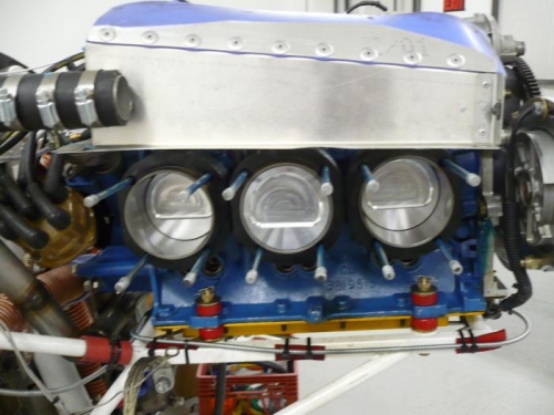

Date:  1-12-2013
Number of Hours:  4.00
Brief Description:  Assemble rods to crank
Cleaned the crank journals and lubed cam and crank with assembly lube. Torqued ARP rod nuts to 27 ft lbs with moly lube on the threads.
Test fit the heads to determine which head bosses need spot facing.
