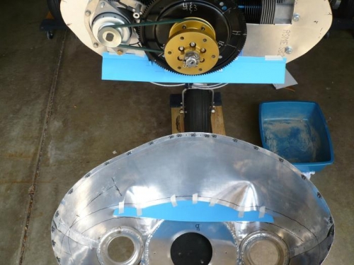

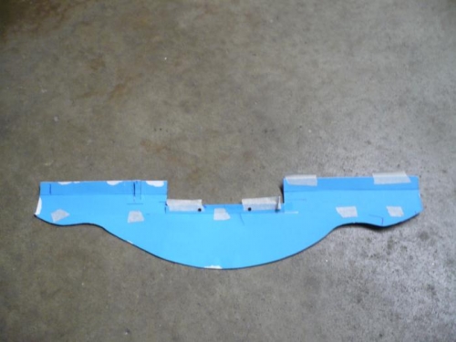

Front Center Baffel
Blend two templates into one. One coming off the front of the engine and one coming back from inside the lower cowling.
Test fit and trim several times then make it out of metal and trim the leading edge back to get the .5" gap.
