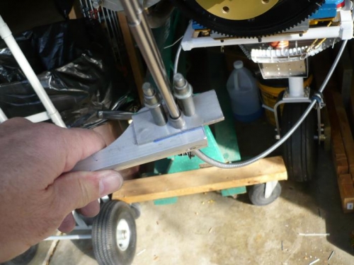

Brief Description:  Throttle cables and steel lock nuts
Finished the cable stop which is three parts, two 1/8" aluminium with 1/4" notches 1/8 deep and spaced 3/8" apart. these two parts fit inside the grooves on the cable ends and are held in place with 1 AN3-5 bolt each to the angle bracket.
Added Adel clamps about 3" ahead of the firewall and grometted the cables where it runs through the firewall.
Added MS21042 nutes to the adel clamps and carb mounting bolts.
