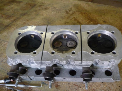

Didn't take any pictures of the repair Roy did yesterday but the head is ready to clean up and replace.

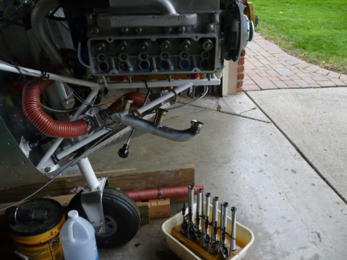

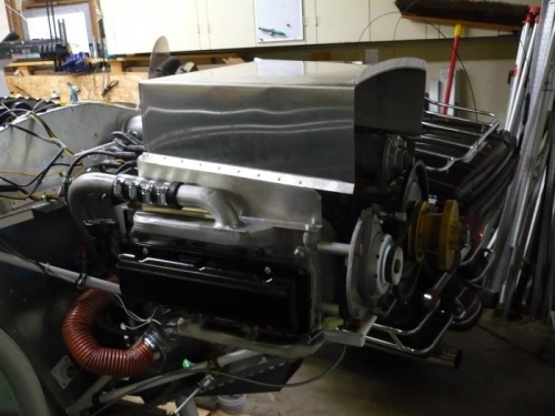

Reassembly, to adjust the valves I removed the other valve cover and used the inverted firing order to bring the oposing cylinder to TDC to adjust its valves. Tighten to remove slop, and 3/4 turn more.
145236 is the firing order so
145 236
Is the order of inversion. Rotate engine so opposite cylinder is rocking on overlap between exhaust and intake, adjust the other cylinder which is at firing position.
