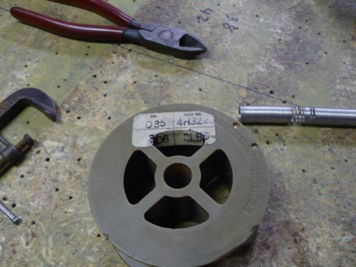

Made new coils of .032" 308 Stainless Wire to replace the mild steel ones that are in the heat muff now. A welder friend gave me the mig wire and asked me to return what I don't need.

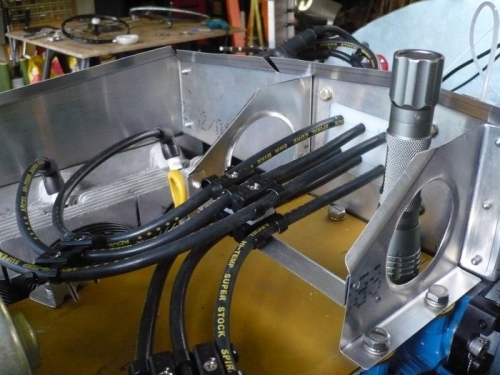

Made a .25" spacer to keep the plug wires apart from two pieces of .125 flat nylon.
