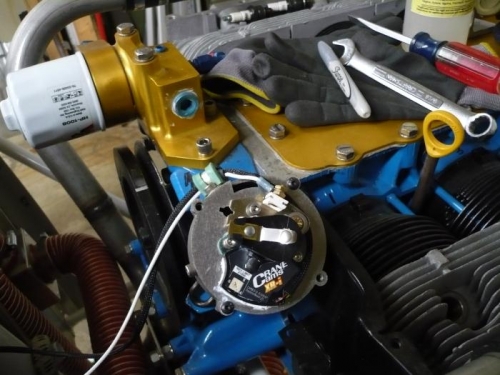

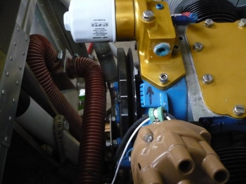

Pulled all plugs and verified distributor placement, points open at 12 degrees.
Marked 16 and 32 degrees Before TDC to set timing.

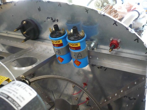

Bolted Coil Switcher, Coils and Pass Through.
Mark TDC
Mark 16 and 32 degrees BTDC
Switcher, Coils, Pass through
