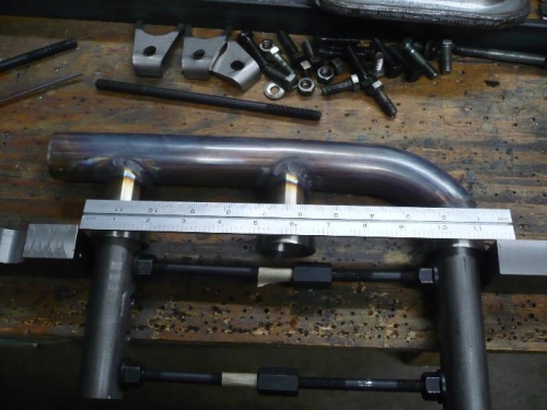

While still hot, measure and adjust jack screws to get dimension.

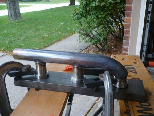

Press exhaust manifold on fixture, clamp flanges where raised. Heat tube and tighten clamps to get flanges flat to fixture.
Leave clamped and let it cool.

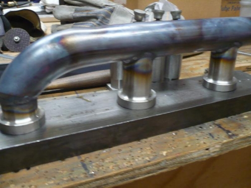

Pry off fixture and test fit back on engine, IT FITS!!!
Check length
