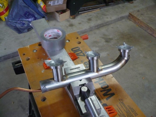

Purge weld exhaust manifold
Cap off holes to hold the argon inside.
The tape melts as the welding progresses, keep the holes covered. I had to let one cool while I welded the other about half way and the tape melts through.
Argon feeds from copper tube

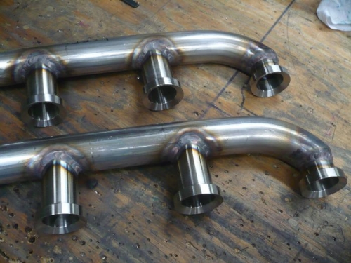

Ready to machine and pressure test

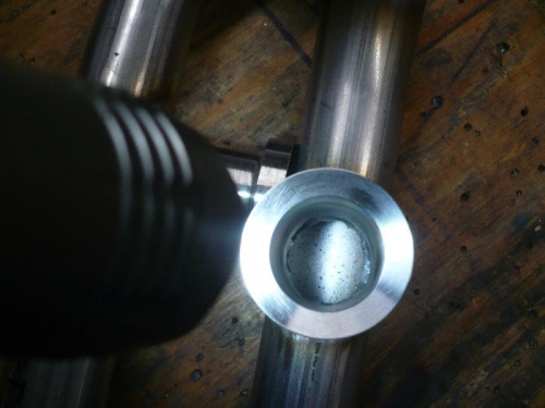

Good penetration
