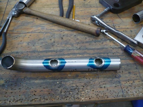

Date:  9-20-2010
Number of Hours:  1.25
Brief Description:  Rough cut holes

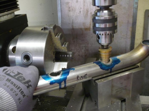

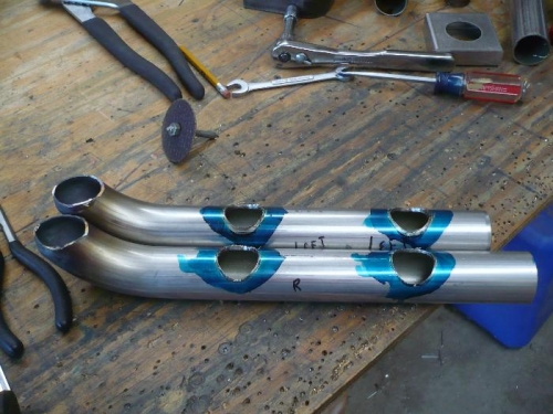

Located stubs and blued up the area and scribed the OD of the stub. The bluing left a clear spot on the inside so I just use that to guide the rough cuts.
Had to NOT go to deep with this tool, don't want to go through.
Used die grinder and a diamond-cut carbide acorn burr to clean up the hole.
