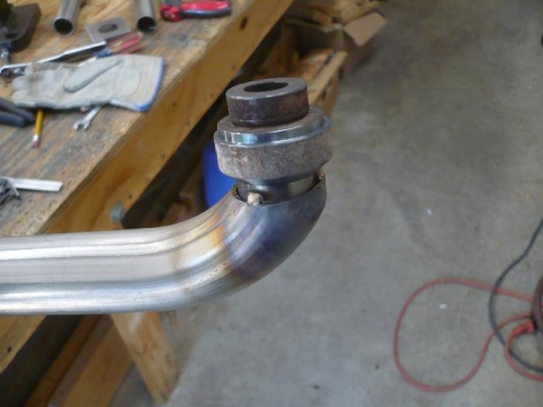

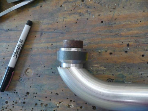

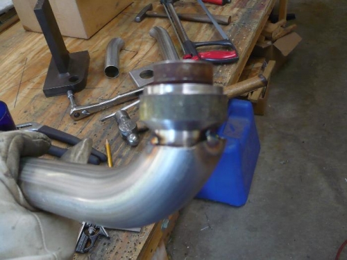

Shape exhaust manifold end
Turned down a solid steel plug, 3/16" radius on the end, and inserted it .2" into the front bend cutout.
Tack welded where it touched the plug.
Used Oxy-acetylene torch to heat tube red hot and with a ball peen hammer, formed the tube to the plug.
