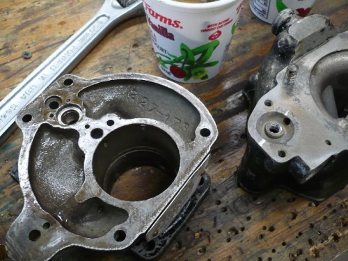

Remove stuck parts from Carb
Setup carb and trammed in the OD od this boss. Drilled with number drills till I could see the threads.
Looks like 1/4-20 threads for the orfice / check ball.
Float seat was stuck so I made up the 50/50 Acetone/ATF mix, heated, beated and ground down a pry bar to get it free.
What fell out at the end
