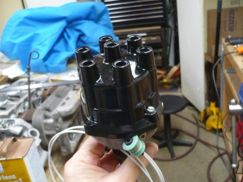

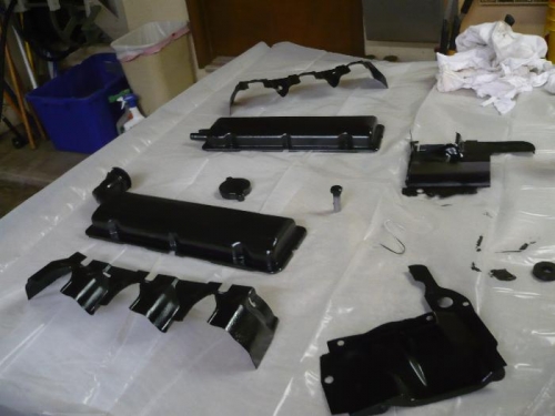

Painted valve covers, sheilds, clamps and while waiting for paint to dry, wired distributor and fixed 10-32 mistake in cap.
Removed the 8-32 screw and replaced it with a 10-32, I tapped the distributor base to 10-32 for both holes. Used 14 gage wire and full circle connectors, adel clamp, vacumn hose and skrink tube (two layers) to protect the wires.

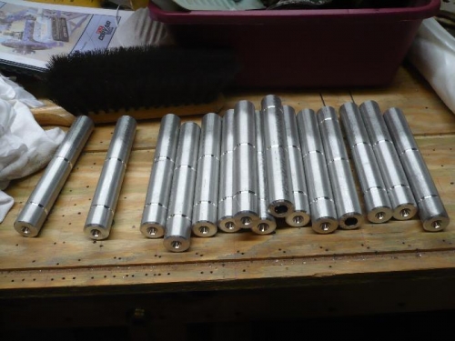

Grooved safety shafts and drilled two .5" ID.
