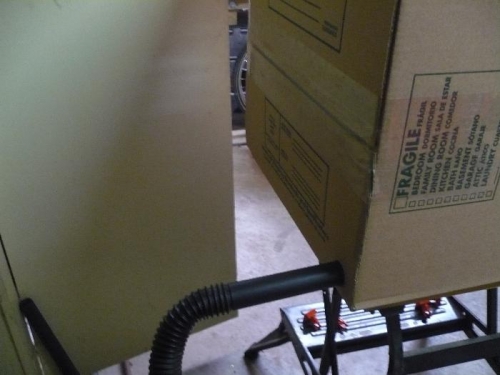

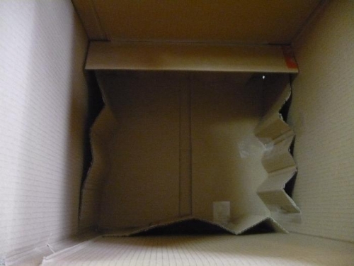

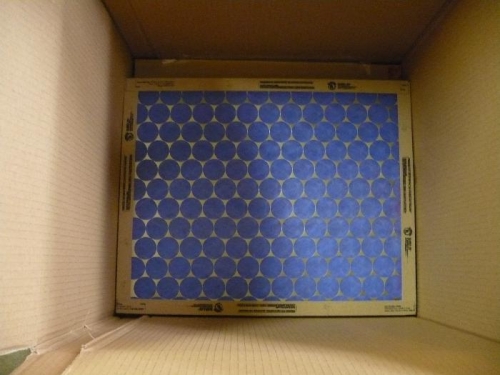

While I was waiting I constructed this little spray booth from cardboard boxes packing tape and a furnace filter. With a couple of large boxes strategically cut, supports and gap filler were created and taped in place to hold the filter. 1 - 1/4 hole saw through the back and insert the shopvac hose. Works real good for keeping the overspray under control.
