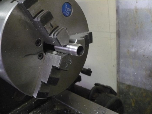

Turned down tubes for oil system vent and reclaim of oil.

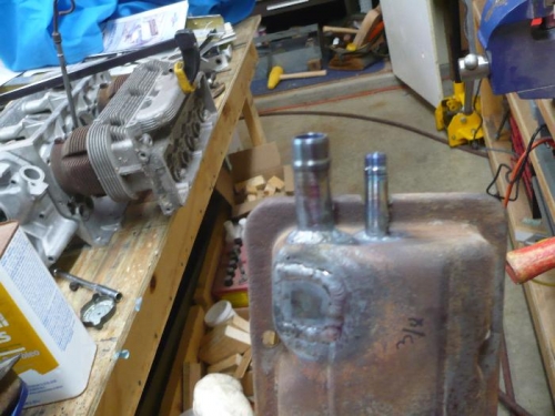

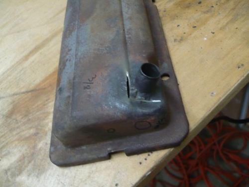

The left cover had this coming out of it so I cut it out and patched it.
Then drilled holes and welded the tubes in place.
