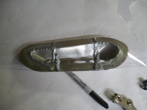

Brief Description:  Layout and trim end cap for light fixture 1 of 3
The nice thing about the clear acetate is you can see through it. I clecoed the light fixture to the acetate and marked the hole to cut by following the weld on the inside of the weldment.
Light fixture clecoed to acetate

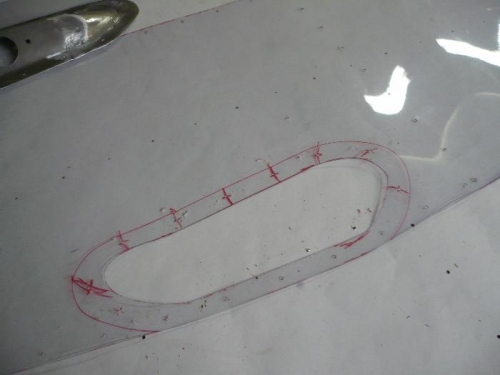

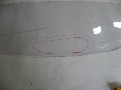

Trim out acetate
Trim out acetate
Mark the rivet holes
