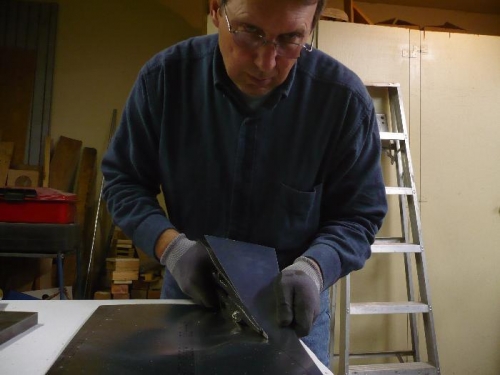

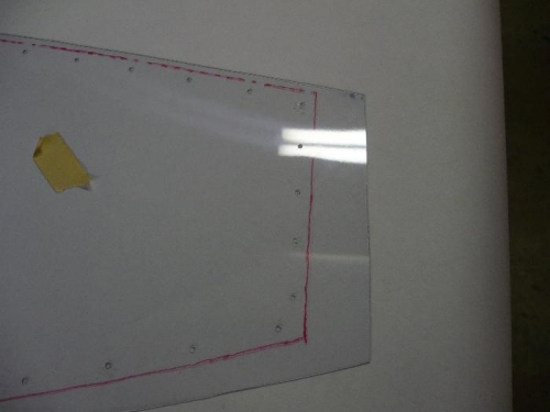

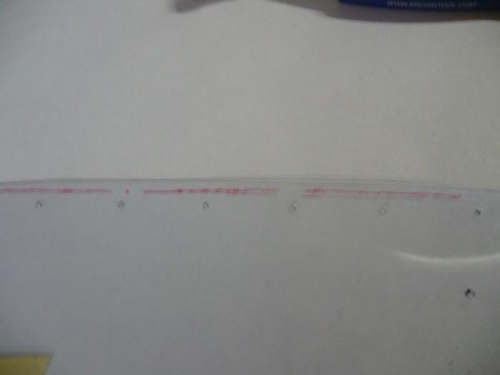

Right Wing tip end cap plate 4 of 5
Trim the template and transfer layout to .025 6061-T6 material. Center punch all the rivet holes and drill then all .060" dia. Open every other hole to 3/32" dia then trim out the perimeter.
