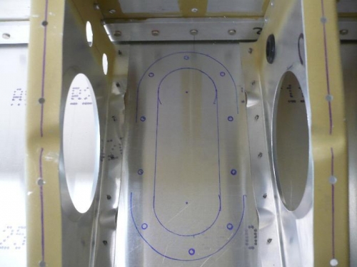

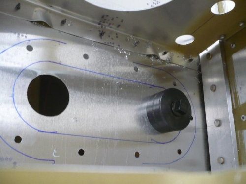

Connect the inner outlines, Center punch and pilot drill all hole centers. Drill all screw holes to7/32" dia. Drill center hole for slot and use 1.5" dia knock out punch to rough in the hole.
Snip out center section of slot.
Connect the lines for slot

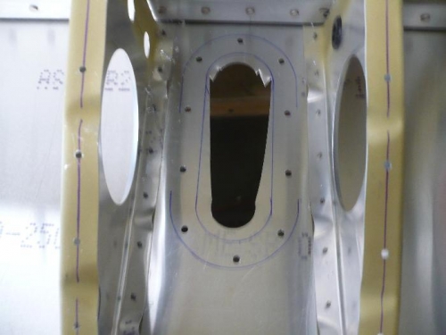

Punch out holes
Snip out the center
