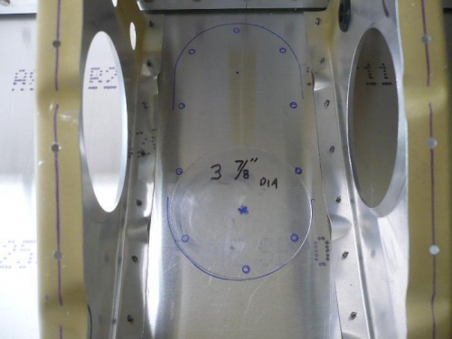

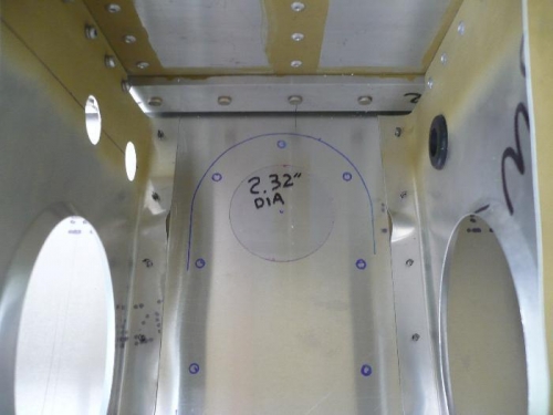

Tank End Access Cover 2 of 6
With the 3-7/8" dia template transfer the center by aligining to outline.
With the 2.32" dia template line up the center and trace the outline of the end holes.

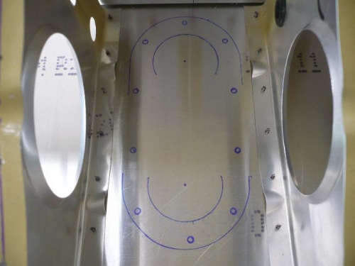

Line up outline, mark centers
Line up center, mark outline
results
