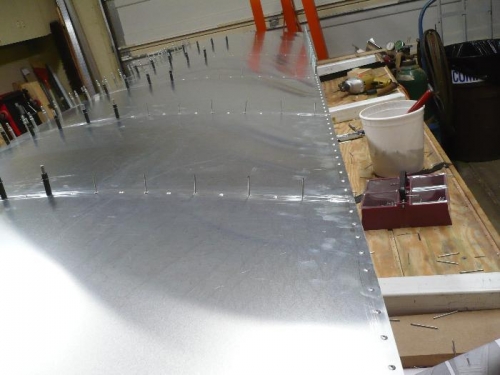

Riveted top skin and left out some rivets in ribs 4 & 5 to make the wing locker.

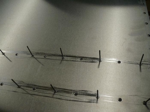

Went along rear spar every other hole first then every other hole along the ribs moving from center out and forward one rivet line at a time. Removed clecoes when I could reach any further and filled the rest of the the rear half with rivets.
Moved my body the the front of the wing and reached in and kept bringing the rivet line forward. Got to the front spar, removed clecoes and filled the rest, (except the 4 & 5 ribs every other hole by the wing locker) with rivets. The entire front spar is still clecoed with silver.

Halfway forward
Halfway forward
Close up or top rear wing skin
