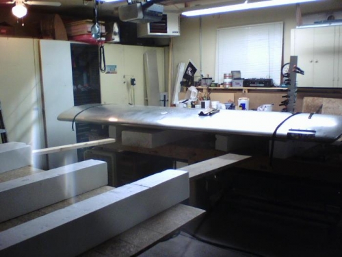

Brief Description:  Hang Left Wing for Storage
Built ramps between two tables to scooch the wing across the garage so it was below the hanging spot. What isn't shown is how I did it.
I have eight hooks in the ceiling trusses that I hung me from to make sure they were strong enough. The hooks are spaced about 10 ft. apart and 4 inches from each other, the strap span is 6 ft. What I did is use the 4 ratchet straps to raise the wing up. I did this little by little end to end and balanced the wing as it was raised. Didn't take pictures be cause I wanted to get it up there fast and held with the straps.
The wing has a tendency to hang leading edge low, as the wing was raised I had to push up on the leading edge to get it to balance.
Before
Before
After
After
Clears the garage door
