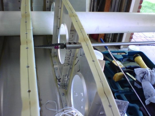

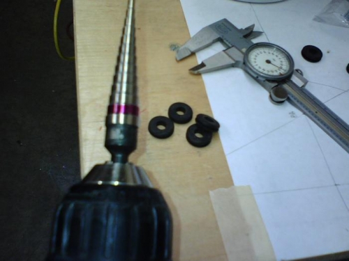

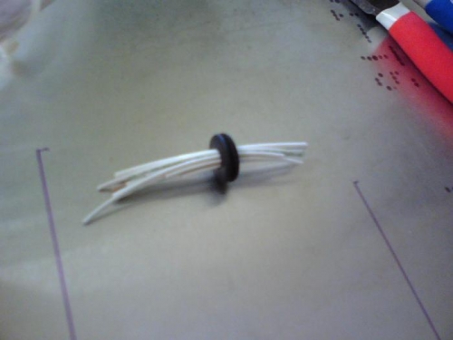

Started today making the holes for the 5 wires to the wing tip. Three are AWG 14 (Landing / Taxi / Strobe) and two are AWG 18 (NAV /POS). I marked the drill so I would know when to stop and used an extension to get between the tight ribs.
No conduit here, just the grommets and some wrap around material, see next page.
Depth mark on drill
Depth mark on drill
Extension in use
Extension in use
Check grommet size
Check grommet size
