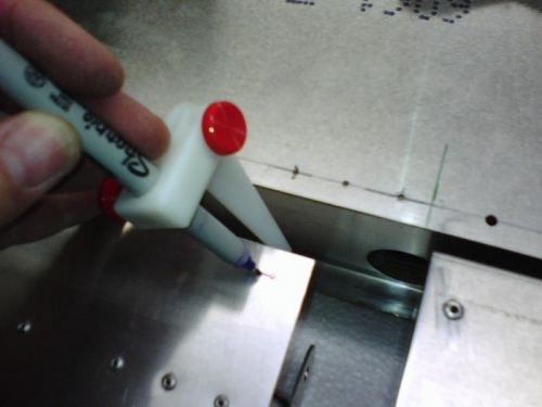

Brief Description:  Mark start hole of Alieron rivet line 3 of 4
Sandwich the Alieron between the top skin and the Rear Spar. Bring the Alieron toe the 85mm line and but the flap tip end, then mark the first hole of the Alieron rivet line.
Image 2) Extend the rivet line the whole length of the alieron. Re position and silver cleco the inboard end of the Alieron.
Image 3) Line up the aileron rivet line at the outboard end and noticed the red trim line lines right up with the end of the Aileron. Cleco the whole line.
Line up 85mm and Flap tip
Extend the rivet line full length
Lines up good to the trim line
