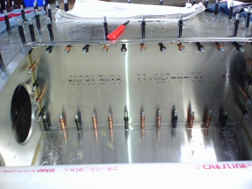

Turned the rivets around on NR 3 & 4, they were facing the fuel tank area.
Image 2) Opening the rivet holes to size in the whole wing locker assembly. Nothing moves, cleco in as many holes as posible.
Image 3) Removed one rivet from the corner springs on the rear panel DZUS Strip so they would remain in position by the rivets in the rib DZUS Strips. Took the entire wing locker saaembly off to deburr and prime.
Turning rivets around
Corner of DZUS Strip
