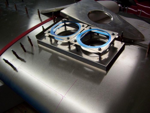

Brief Description:  Landing Light H/W
Getting ready to cutout LE Skin for the Landing Light. Noticed I forgot to flange the Face Plate after consulting the print. Checked the Dia of the hole also and it needed opening for the light to nestle properly, so. . .

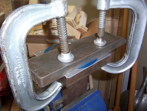

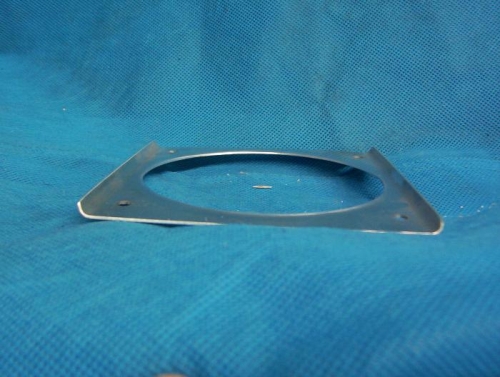

Image 2) Flange the Face Plate. Offset flange 4.5mm because they are already 126mm without the flange. I hope it fits! Hammer flanges and checked the light clearance, IT FITS!
Even though it's short, the dimension is now 119mm to the outside of the flange, it still clears the bulb. I think it's a keeper.
