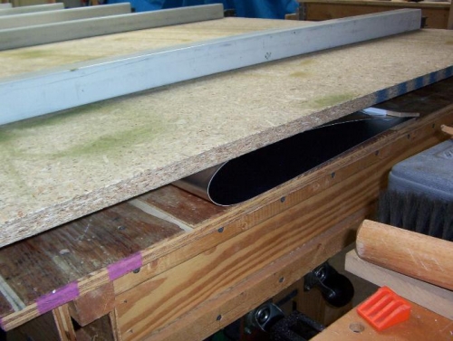

Brief Description:  Re make LE Skin

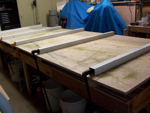

Positioned banded part on the clean work table, set 10 down stops at 58mm and set some uprights to prevent 3/4 MDF from slipping off the back edge. Positioned the 3/4" MDF over the part then positioned the 2 x 2 x 4 steel beams and clamped one edge.
Image 1) Entire 4' x 12' table is covered and clamped lightly to the 58mm stop blocks.
Image 2) End view of clamped press.

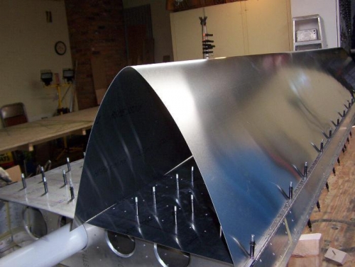

Image 3) Done for the night, SEWPRO will sleep inside tonight.
Press clamped down

end view of press

Skin resting on wing bottom
