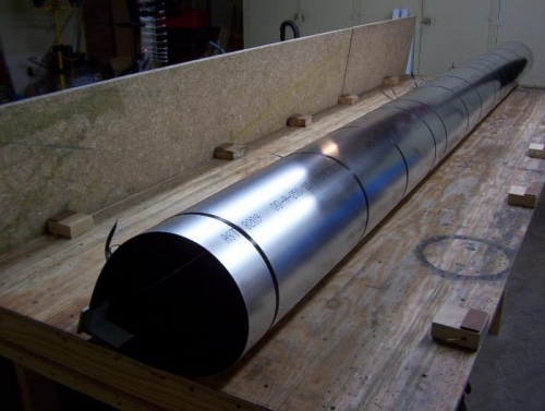

Brief Description:  Prepare and press the LE Skin

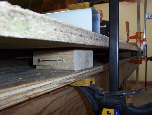

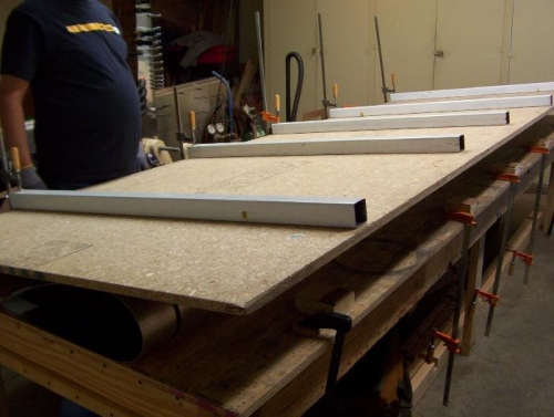

Decided to make the stops 1.75. Cleaned off the table top and pulled out the 3/4" MDF cutting table tops to use as the press ram. Offset the big end of the fold 12" from the right edge of the table top. The plan is to place the MDF on top ot the metal, 2" x 2" x 48" cross beams in five places then clamp the works down to the table.
Image 2) Get the wood in place then add the steel 2x2's and clamp the low end.
Image 3) Clamp the high end and slowly close the press to the stops.
