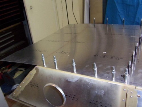

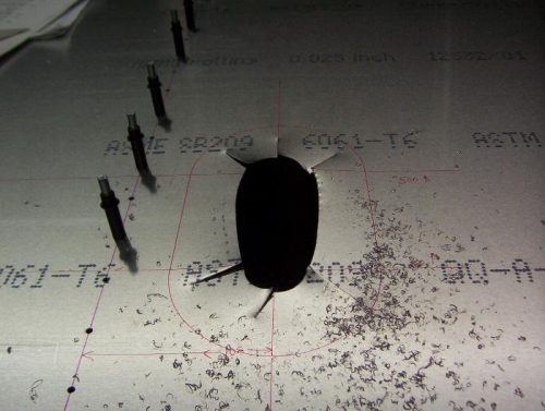

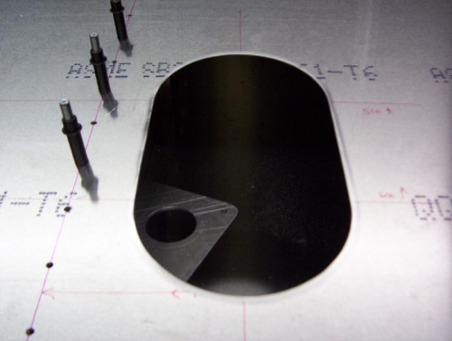

Layed out the Aileron Access Hole in the lower rear wing skin. Poked two 1.5" holes with a hole saw and snipped & filed the rest. Started with the pro snips then switched to the regular aviation snips to get close to the line. Finished up with smooth half round file, 80 grit flapper wheel followed by the scotch brite flapper wheel.
Also layed out the cover then took a break.
Layout and trim
Layout and trim
After scotchbrite wheel
