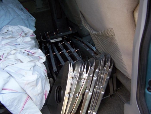

Made up a fix for the missing metal on RR9 and some small angles for the bottom leading edge of the rear ribs. I just want to make sure the rivets have good metal to pull the lower bottom rear rib to the spar angles. Made up some small .025" x 1.1" x 1" x 1" angles to rivet to the webs at the joggle. Deburred and installed on all left rear ribs with 3/32 clecoes.
Mixed up 6oz of primer for the air brush. Taking all left ribs, all nose ribs, spar tips to work to use the spray booth tonight.
Ready to clean and prime
