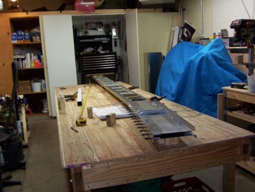

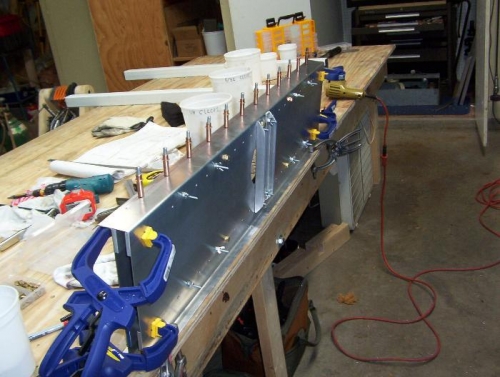

Finished center spar, angles, flanged holes, A5 rivet line, and layout notch trim.
Added spar tips to the spars.

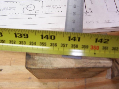

Set it all up to set the wing dihedral. 355 up and 3588 over.
I will let it set overnight before drilling the six 5/16 attach bolt holes. Might wanna put it on the mean -5mm.
