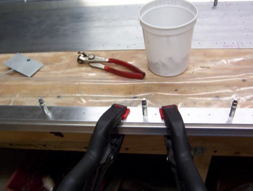

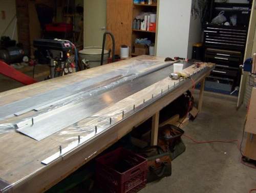

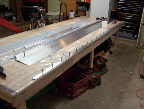

Manual Reference:  6W3-6 & 7
Brief Description:  Pilot drill Wing Spar Cap Angles
6th. Re-position the clamps between the two clecos and repeat the 3rd and 4th steps.
7th Continue the repeat process 8 holes out then 4 holes in till the entire spar cap angle is clecoed in position the entire length.
8th. When it is all clecoed to the table pilot drill all the rest of the holes. Remember to let the drill motor stop before placing it in the next hole.
