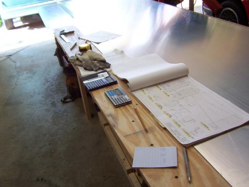

Just cleaned up burrs for safe handiling, clecoed in a few places and stored them on the back porch while I cut more metal.
Pulled out .032 sheet and began laying out all the parts from it. I made some templates to mark the multiple parts 6W3-9's. It make it easier to nest the parts using a template.
.032 sheet layout
.032 sheet layout
With a template you can nest parts
