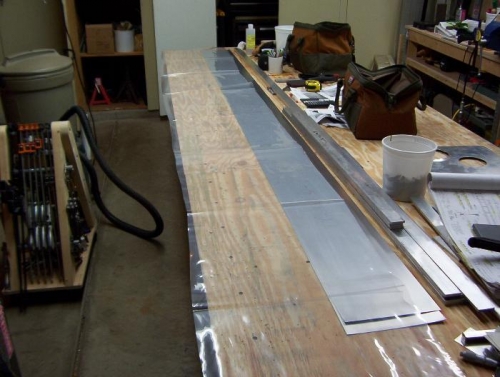

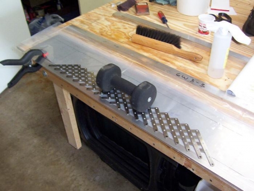

After sanding the table top I layed down some visqueen then layed down one wing spar web, then I folded the visqueen over the top and layed down the spar web with the layout. I used a loose piece of visqueen between the rivet fan and the part also.
Finished laying out rivet holes. I used visqueen to help keep the surface scratch free.

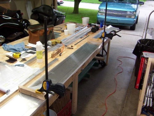

Next it was line up the two wing spar webs, ends and edges, and clamp down to table top, (notice the visqueen under the maple blocks).
Visqueen on table top
Protect that spar web
Line it up and clamp it down
