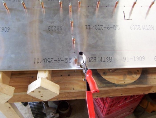

1) To get the snips started, drill 5/8" holes, top & bottom, 1/4" away from trim line using Blair cutter, piloted drill first with 1/16" drill to keep the cutter in place.

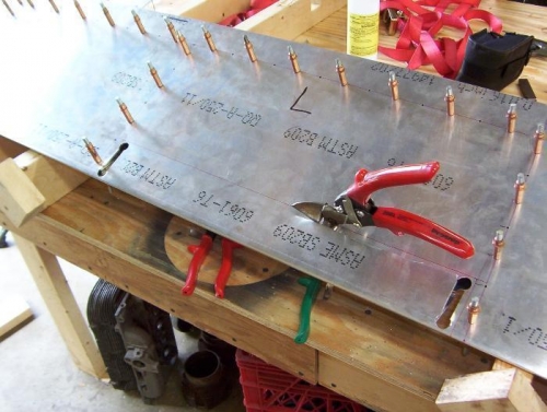

2) Snip from trailing edge forward with avaition snips staying 1/2" away from trim line. Make another cut closer, using the other hand snip, to trim to remove about 1/2" opening.

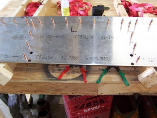

3) ProSnips (offset snips) staying 1/2" away from trim cutout length, top & bottom. Snip trailing edges, top hole to bottom hole, to remove large piece.
4) Using a Pipin file, file radius to the intersection corners, top & bottom.
5) Starting from the middle, final trim, split the line, towards the corner radius. Be careful at the end of the cut. (better to break it off than to slip & cut into the radius)
Drill 5/8
Drill 5/8" holes 1/4" from trim line.
Hole to hole inside first
Cutout length 1/2
Cutout length 1/2" away
