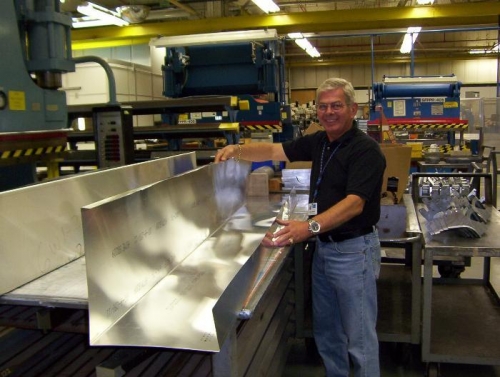

Cut metal for skins and Nose Ribs. Coiled 6w1-2 and took to work to bend in their press brake.
The developed bend lines wer entered into the backgage and each bend was made to a known dimension. All bends were made using the same gage edge as a locator.
Made bends just over 90 degrees so they would be easier to qualify.
Frank Lambrecht helped hold metal in the press brake.
Frank holding bent flap.
