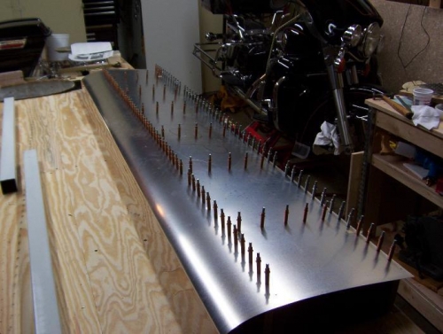

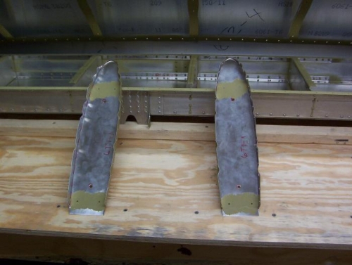

Finished fitting skin & End Caps. Took it all down and deburred holes and scuffed the mating surfaces with ScotchBrite to prepair for paint (primer). Wiped it all down with Laquer Thinner. Cleaned up everything and applied primer. Let it set overnight to dry with the heat on for 6 hours.
Top Skin clecoed
Top Skin clecoed
Fit end caps & prep for primer
