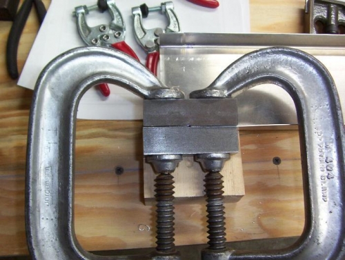

Joggled the front spar ends .025 to clear the end caps. Touched up primer with brush on the spar ends and attached the L angles to the front spar.
Joggle block
Waiting for the primer to dry to begin riveting.
