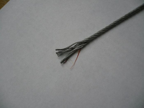

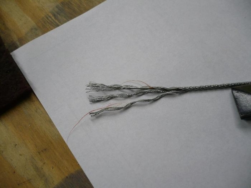

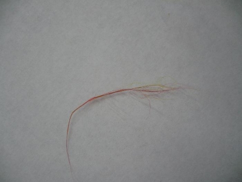

I checked the cable I got from ACS and it is MIL-DTL-83420 with a red and gold filament.
Wire rope used as flight-critical aircraft control cable must meet MIL-DTL 83420 (latest revision). It is estimated (Defense Daily Network July 27, 2005) that less than 2% of "aircraft control cable sold in the world today meets MIL-DTL-83420. Most of it is what you would find in your local hardware store." Tests performed on non-MIL-DTL-83420 cable concluded that the fatigue strength requirements were rarely met.
If your log book entry or sales receipt uses the term "aircraft control cable" then you might be implying that the cable is MIL-DTL-83420 when it is not.
There are two easy identification methods that may help you identify aircraft control cable:
(1) All MIL-DTL-83420 contains a two-color tracer filament embeded within the cable that identifies the manufacturer,
(2) All MIL-DTL-83420 cable sold on a shipping real must contain the identification number of the manufacturing reel. (All MIL-DTL-83420 cable is lubricated with a corrosion inhibiter.)
