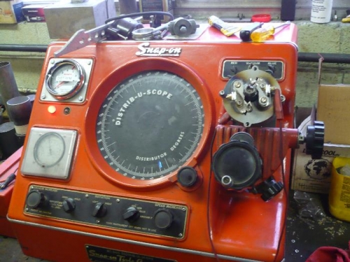

My friend Terry let me use his Distributor machine to set the advaance curve for the flight engine distributor.

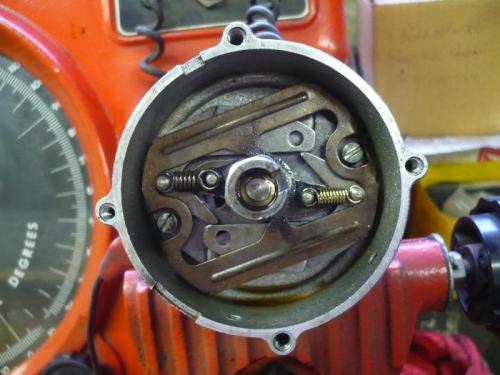

700 RPM no advance, 2450 RPM full advance.
Using one original and one new spring.
Set dwell on both points to around 28-30 comes out to around .023 feeler gage.
10 degrees full advance.
