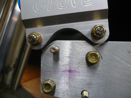

Brief Description:  Make clearance for calipers on the main gear
Checked two other Zodiac XL's and noticed they had the gear reversed. I flew both these planes and they both drop the nose wheel very quickly on landing. With the heavy Corvair engine I will favor keeping the straight edge forward to keep the main gear closer to CG.
Trim off excess
Trim off excess
Check clearance
Check clearance
Dress finish, deburr
