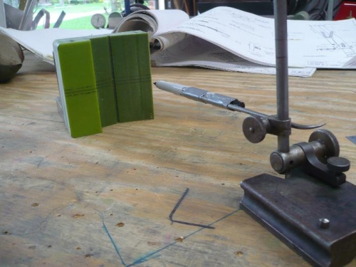

There is about 6mm of extra material in the middle. Layout lines and cut on band saw to seperate the two halves.

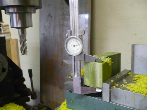

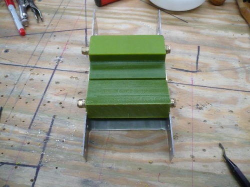

Size needs to be 1.85". Get setup on one side then mill split surface fully, swap halves and macinie the other side. Bolt together and check for fit.
Layout split line
Machine to size
Check for fit
