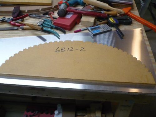

Brief Description:  Making 6b12-2 Baggage Back Bulkhead
One mose of the longer bulkheads I had to shrink the straight flange to get the panel flat and have that bend line straight. Very light but it came right in. I went over on one and had to stretch it back out with a hammer and anvil to get it back to straight.
I hope the care I've spent on these will make the assembly go easier.
