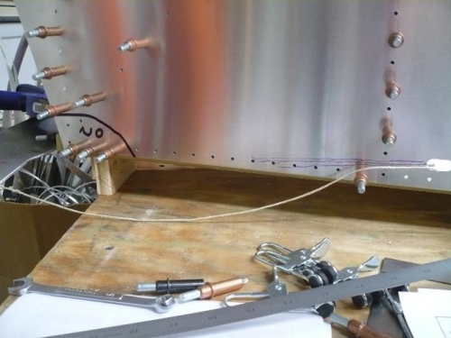

Attached lower rear hinge and ran some string into the cable opening of the side skin. Held string tight and marked the line the cable will travel on the skin.

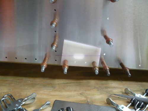

Transfered that line to the fairlead

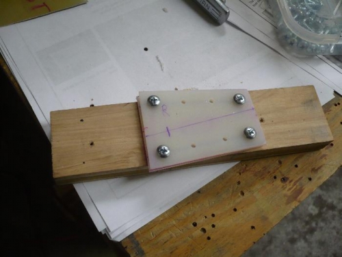

Then screwed both to a board to mill the 1/8" slot.
